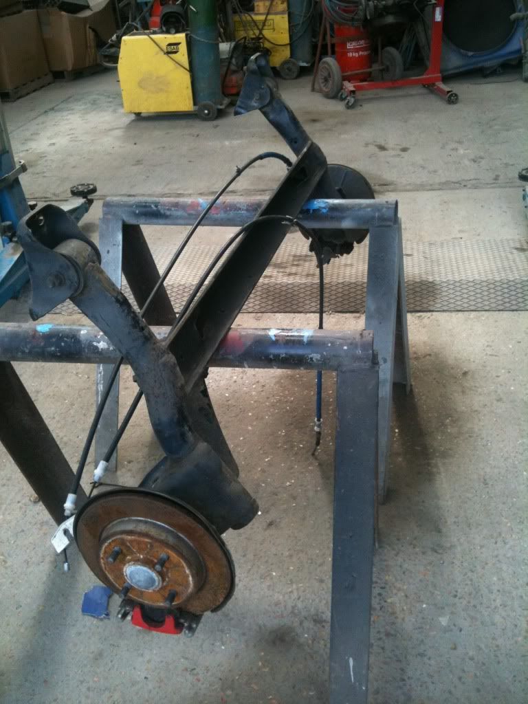

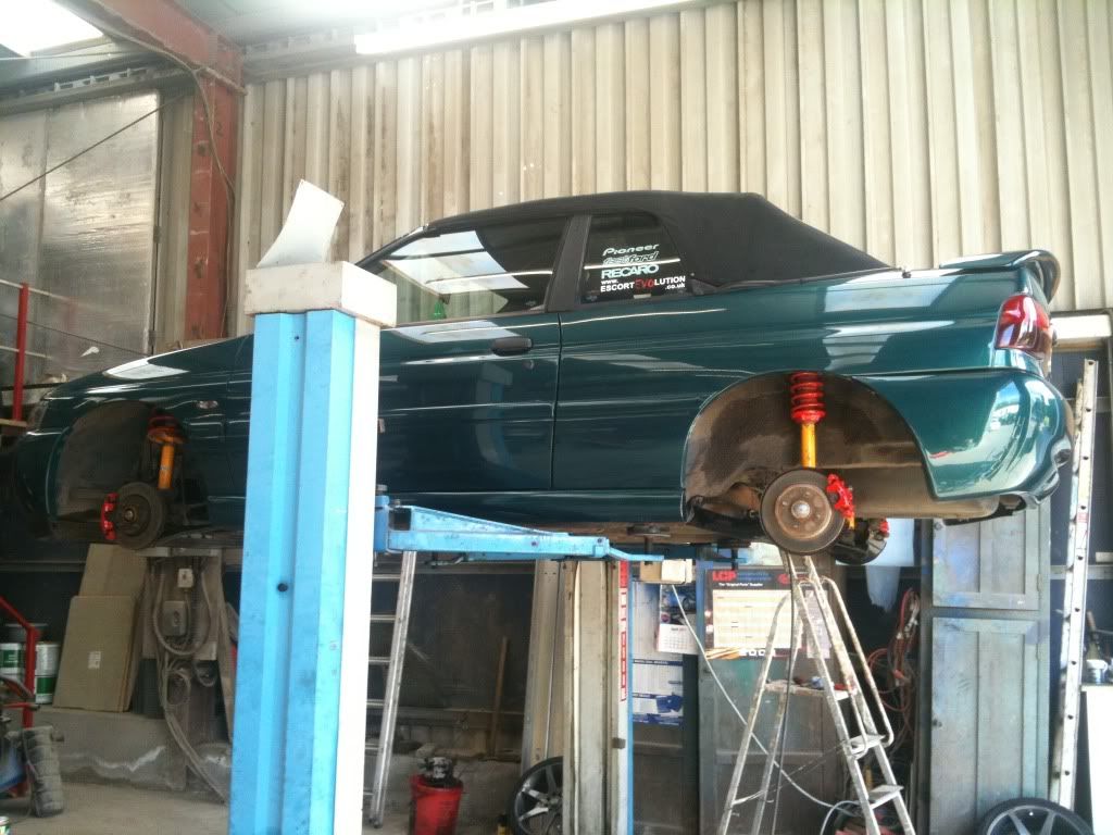

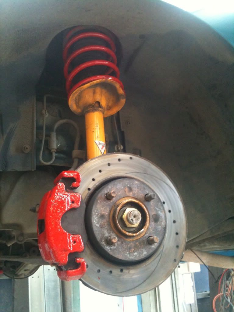

Now has a new rear axle (gti) with 2.0 Focus discs. Needed some rear brake hoses from a Mondeo to fit but other than that the conversion went smoothly. Nice (slightly) wider stance at rear which will require a little bit of arch rolling to stop scrubbing with passengers/bumps. Front and rear calipers now painted red which looks great IMO.

what did u do about hand brake i got st170 rear brakes to fit but no one seems to be sure on this

Not 100% but i'd assume the Focus handbrake itself as clips we slighty different to the Escort one and it's a lot better. I know have a tight handbrake cable and the handbrake itself doesnt come up stupidly high haha

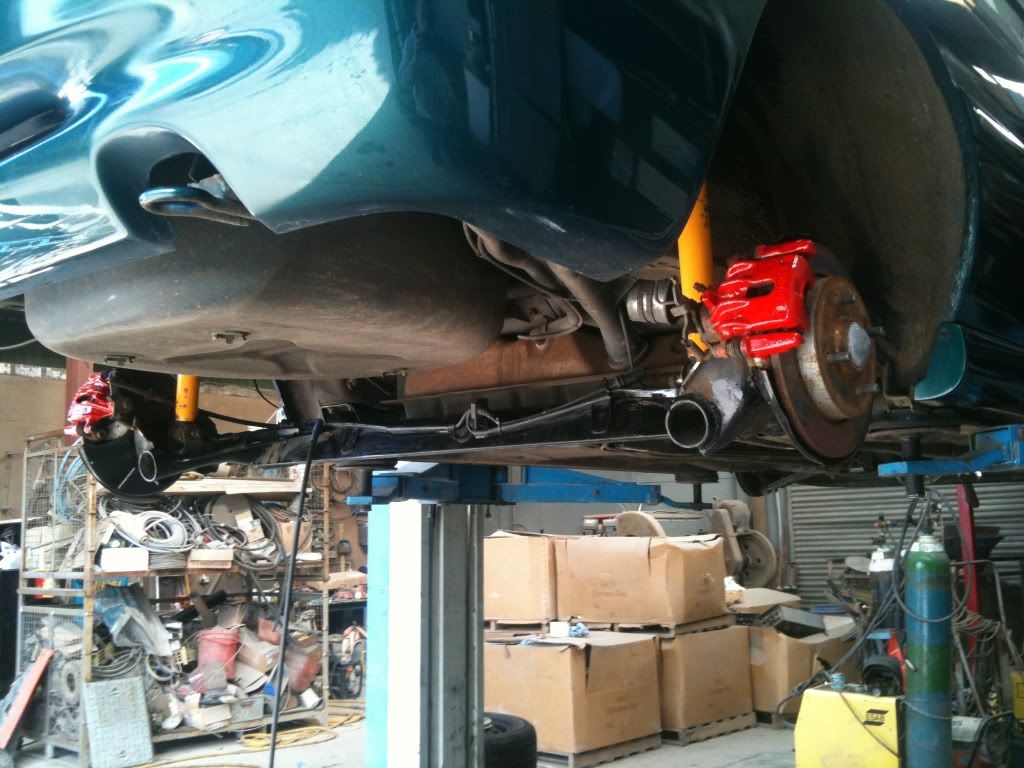

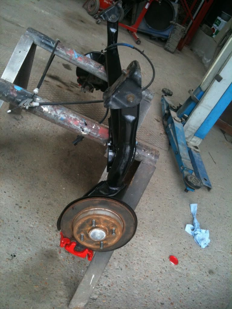

New axle (Cheers Wayne!)
http://i273.photobucket.com/albums/jj208/TC-DNB/IMG_1135.jpg
Black hammerite all over and calipers painted red
http://i273.photobucket.com/albums/jj208/TC-DNB/IMG_1136.jpg

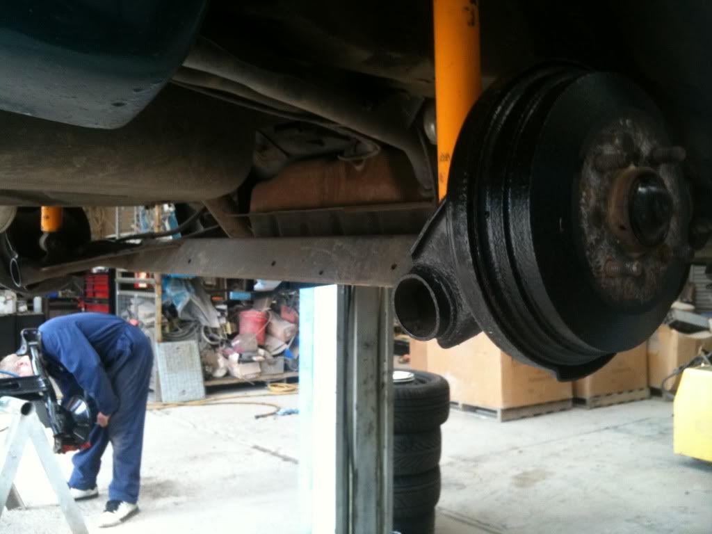

Old axle
http://i273.photobucket.com/albums/jj208/TC-DNB/IMG_1142.jpg

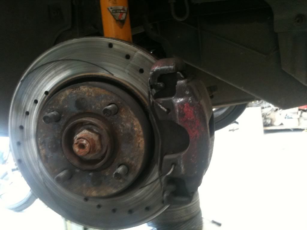

Front brakes before clean up/paint
http://i273.photobucket.com/albums/jj208/TC-DNB/IMG_1143.jpg
After
http://i273.photobucket.com/albums/jj208/TC-DNB/IMG_1148.jpg

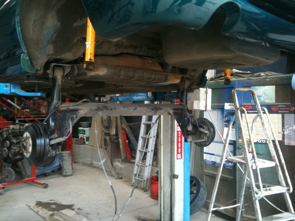

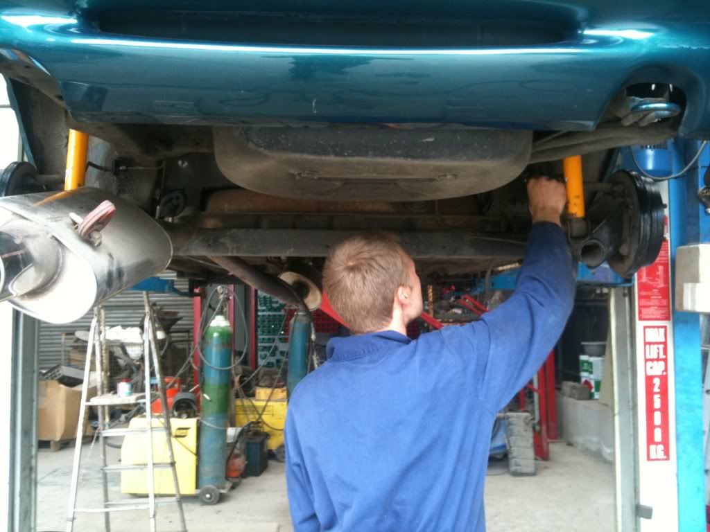

Man at work
http://i273.photobucket.com/albums/jj208/TC-DNB/IMG_1145.jpg

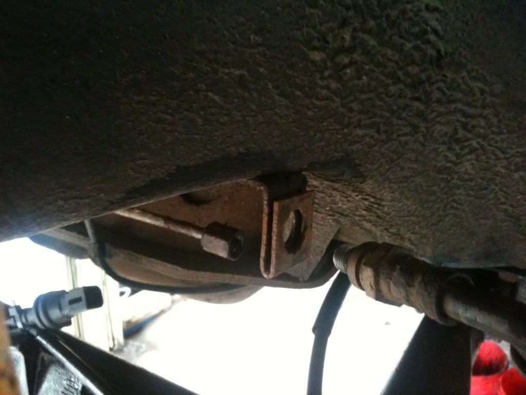

Axle nearly out
http://i273.photobucket.com/albums/jj208/TC-DNB/IMG_1149.jpg
New axle on
http://i273.photobucket.com/albums/jj208/TC-DNB/IMG_1150.jpg

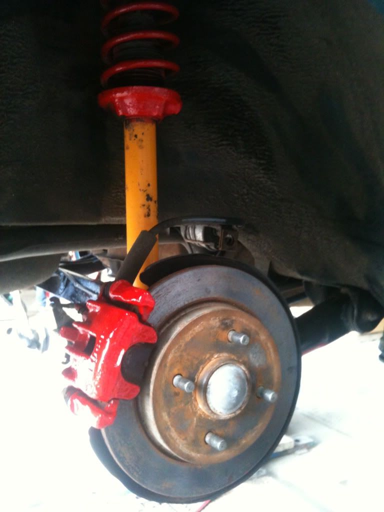

Front and rear disc cleaned and painted
http://i273.photobucket.com/albums/jj208/TC-DNB/IMG_1151.jpg
Rear brakes on
http://i273.photobucket.com/albums/jj208/TC-DNB/IMG_1153.jpg
Original hose too short
http://i273.photobucket.com/albums/jj208/TC-DNB/IMG_1152.jpg
Mondeo hose done the job
http://i273.photobucket.com/albums/jj208/TC-DNB/IMG_1156.jpg

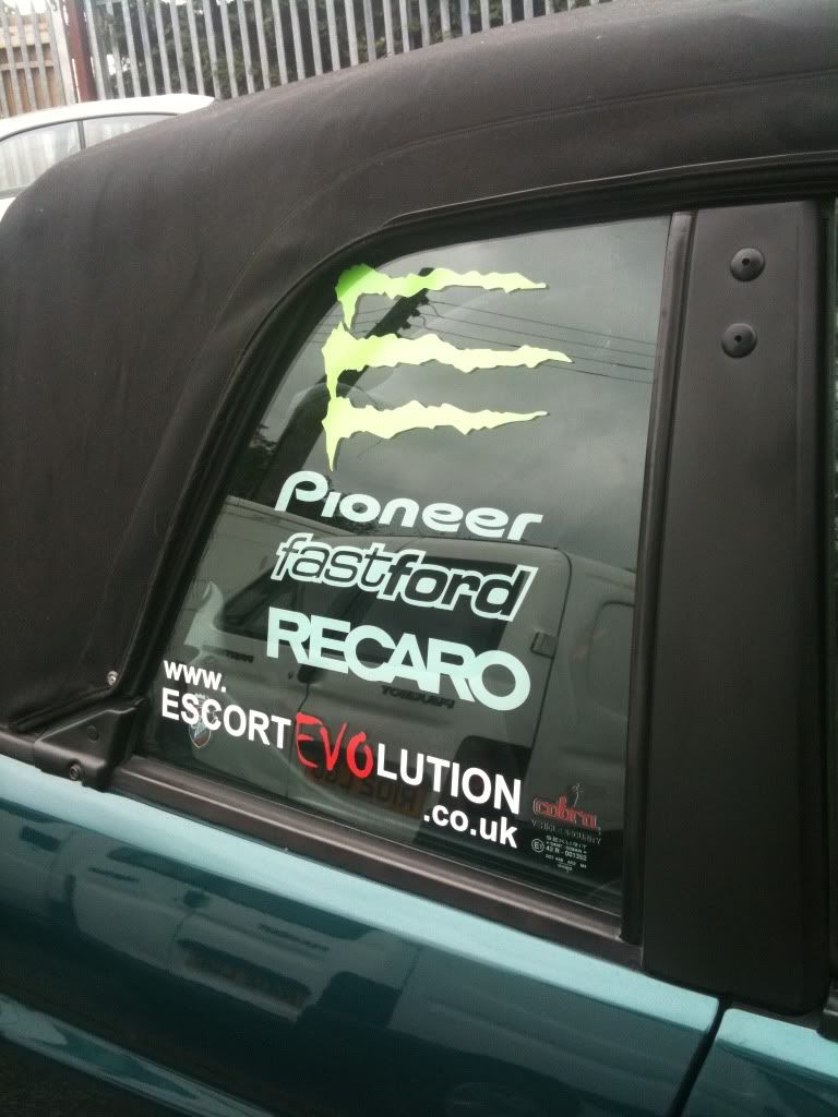

Twisted Monster sticker sideways so it reads E (plus it fitted in the space better ;)). Wasn't sure about stickering the windows up but now they are full i much prefer it.
http://i273.photobucket.com/albums/jj208/TC-DNB/IMG_1163.jpg
As always comments welcome :thumb:
Stickered window looks good and a lot better now the rear has discs. :thumb:
It's much nicer to drive now. Can slow down with confidence and the wider stance at back feels and looks good. Really need to roll the arches though. Rubs like a biatch down all the back roads haha. And yeah I prefer the window now it's full but not sure how long they will last. The word 'chav' comes to mind haha
If you think your braking has noticeably improved since changing to discs on the back I recommend you get it on a brake tester (MOT station) as it may potentially be unsafe. 90% of the braking is done by the front brakes so changing the rears shouldn't make a noticeably difference, if it does it may mean they're way out of balance and potentially dangerous.
Was only on the rollers last month as full service and MOT done. Brakes all tested fine so I shouldn't think the front brakes are an issue but I'll look into it. It's probably more in my mind than anything. Nothing was wrong with brakes - I only changed as bushes in axle had worn out and I didn't like the look of drums. Thanks for the heads up though Stu
