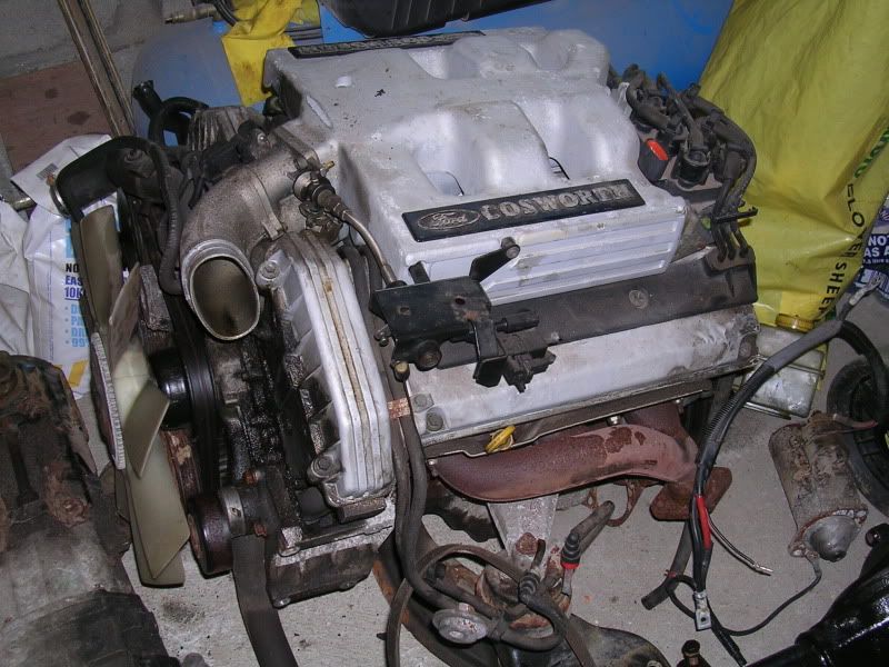

This weekend we picked up my engine(s). I'd originally looked at an entire car in buckie, but the woman wouldn't budge on price, then these 2 came up as a job lot so I jumped at the chance. In typical style after I'd done the deal the woman with the Granada then text to say I could get the car for my offer, it had taken her 4 weeks. Her loss as these were cheaper/less miles and alot less work as they were already removed.
This seems the cleaner of the two so is the one I'm planning to use.
And the other, will keep until the car is up and running just incase its needed for any reason, then either punt it on, keep as a spare or perhaps it might land in another capri...

What engine is that going in? 24v Cossie from?

More than likely granada scorpio lump, capri was 1st car i EVER got behind the wheel of, lol. Good luck with the build.

As others have guessed its a 24v from a Granada Scorpio, this is the BOA version, i.e the earlier one. Its slightly less power that the BOB from the frogeyed scorpio's but its easier to wire being pre pats.
