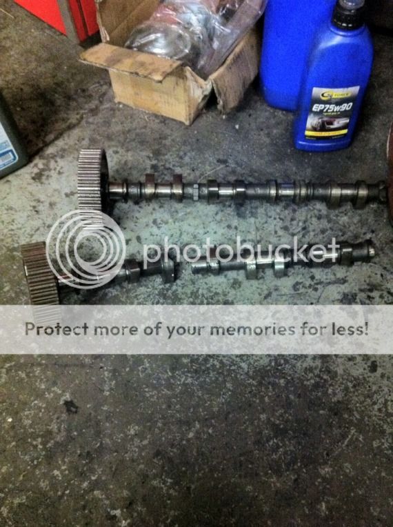

SLEEMAN Posted March 24, 2013 Share Posted March 24, 2013 ouch hope that hasn't messed up anything inside? Link to comment Share on other sites More sharing options...
Ahmotorsport Posted March 24, 2013 Share Posted March 24, 2013 Could have been worse! Link to comment Share on other sites More sharing options...
Stu Posted March 24, 2013 Share Posted March 24, 2013 Ouch. Hopefully that means no bent valves though. Did you tighten the cam caps up in order when you assembled the engine? Link to comment Share on other sites More sharing options...
Andy 3i Posted March 24, 2013 Author Share Posted March 24, 2013 Ouch. Hopefully that means no bent valves though. Did you tighten the cam caps up in order when you assembled the engine?I don't know...wasn't sure there was an order...I just tightened them all down lightly until they were tight, then torqued up Photo evidence http://i985.photobucket.com/albums/ae339/boomshine57th/86A49DE2-2156-4D39-A799-6996BB7A0E2D-12900-0000029A23E2BABD.jpg Link to comment Share on other sites More sharing options...

etrebus Posted March 25, 2013 Share Posted March 25, 2013 (edited) wow i didn't see that comming .hopefully the cams stopped with the valve closed fingers crossed Edited March 25, 2013 by etrebus Link to comment Share on other sites More sharing options...
Stu Posted March 25, 2013 Share Posted March 25, 2013 I have a feeling that'll be unlikely as it had no compression on two cylinders. Link to comment Share on other sites More sharing options...
Andy 3i Posted March 25, 2013 Author Share Posted March 25, 2013 As stu said...no compression so I am expecting the worst really. The head is nearly off anyway because we were going to take it off and just found this once we took the caps off. Link to comment Share on other sites More sharing options...
etrebus Posted March 25, 2013 Share Posted March 25, 2013 (edited) As stu said...no compression so I am expecting the worst really. The head is nearly off anyway because we were going to take it off and just found this once we took the caps off.i tend to agree would be very lucky if they havn't hit  you could always do a leakage test before removing head just to be sure Edited March 25, 2013 by etrebus Link to comment Share on other sites More sharing options...
Andy 3i Posted March 25, 2013 Author Share Posted March 25, 2013 (edited) It's just head bolts holding the head on anyway. We took the exhaust manifold off yesterday but put it back on...no biggy. I'll compression test it again tomorrow but I'm expecting nigh on sod all from 3&4. If its valves just whip it off and take it down the local machine shop or if I can be bothered, get the valve grinding tool out and sort it Edited March 25, 2013 by Andy 3i Link to comment Share on other sites More sharing options...
Stu Posted March 26, 2013 Share Posted March 26, 2013 Get the head properly inspected if there's any damage. Valve guides might be damaged. Link to comment Share on other sites More sharing options...
Andy 3i Posted March 26, 2013 Author Share Posted March 26, 2013 Is that a common thing on zetecs then? Yeah, if I whip it off and it looks remotely damaged I'll send it to the engine specialists and get them to sort it Link to comment Share on other sites More sharing options...
Andy 3i Posted March 26, 2013 Author Share Posted March 26, 2013 Compression test from this morning read 180,180,120,130. Not really conclusive and I'm not 100% happy that nothing is broken Link to comment Share on other sites More sharing options...
Andy 3i Posted March 26, 2013 Author Share Posted March 26, 2013 Took the head off and by some sort of miracle the valves haven't been touched!! I'll get it pressure tested and all back together tomorrow so it's just waiting on the cams . Link to comment Share on other sites More sharing options...
