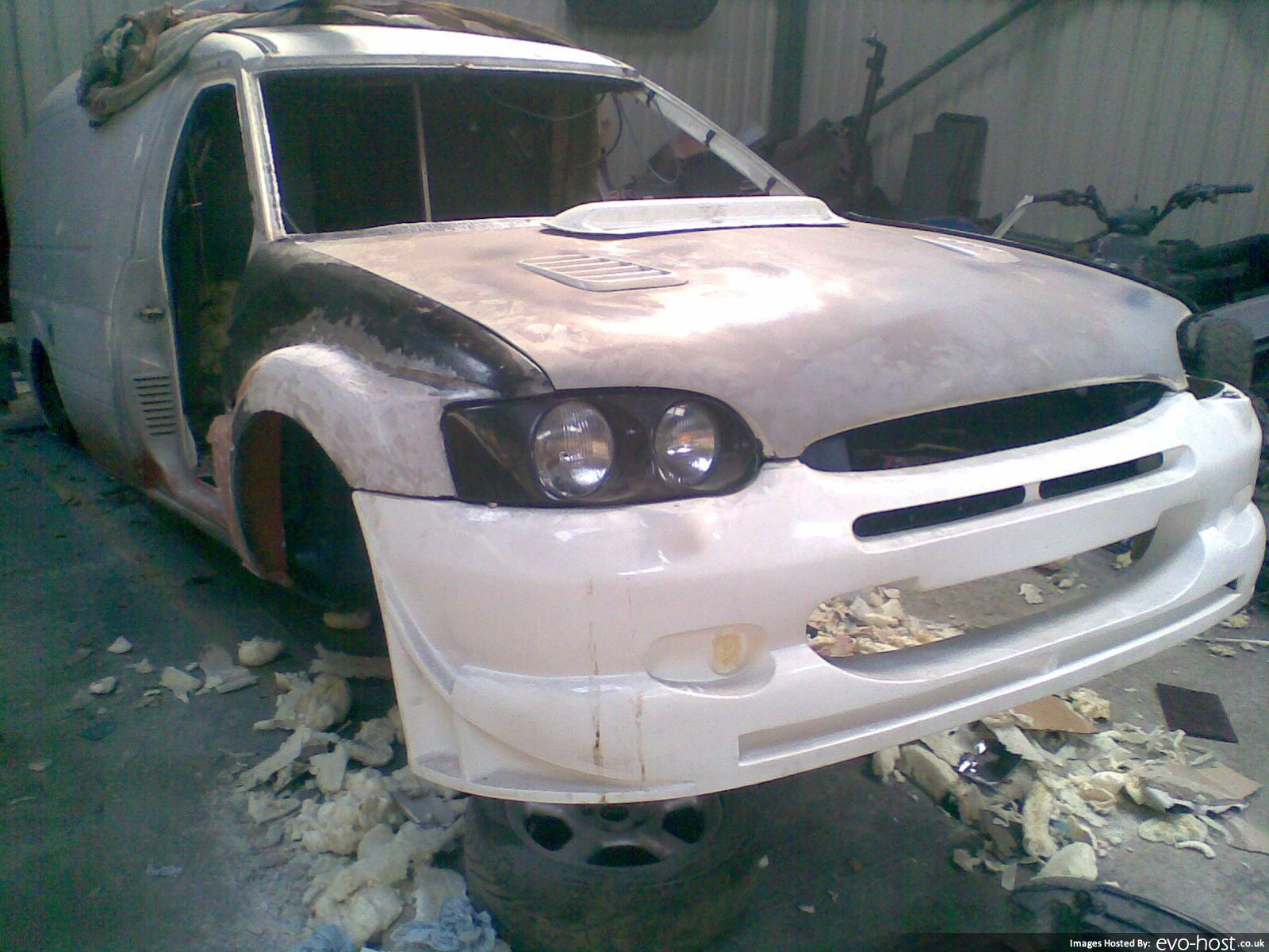

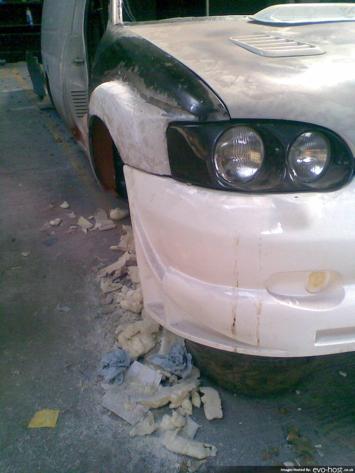

Gti-James Posted October 26, 2008 Author Share Posted October 26, 2008 (edited) UPDATE A couple of pics to show the shape of the arch. once the foam went hard i shaped it and put several layers of fiberglass matting on to make them strong then a skim of fiberglass filler just got to put a skim of filler over it and the same on the other side and blend them in. http://www.evo-host.co.uk/getimg/16096.jpghttp://www.evo-host.co.uk/getimg/16097.jpg The front arches are 1.5 inch wider and the rear will be 3 inch wider on each side Edited October 26, 2008 by Gti-James Link to comment Share on other sites More sharing options...
