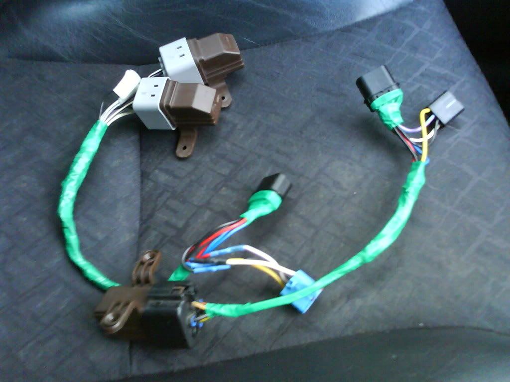

there is a guide some where, or send Mrmetallica money for a nice neat plug and play loom like this:
escorts, ghia's, RS2000, had them in the centre consol

That set made by MrMetallica, would i just plug that into my switch and im all go? And how much would i be paying for such thing?
#14 MCCORNY11
MCCORNY11
  • Location:Kirkcaldy, Fife
  • Drives:Ford Escort SI 1.8 16V
Posted 19 February 2009 - 11:39 PM
yip just plug and play! already done the same for my car like the pics. got one double finished just need another relay to finish my second and will pick one up at the weekend! and these will be up for sale
